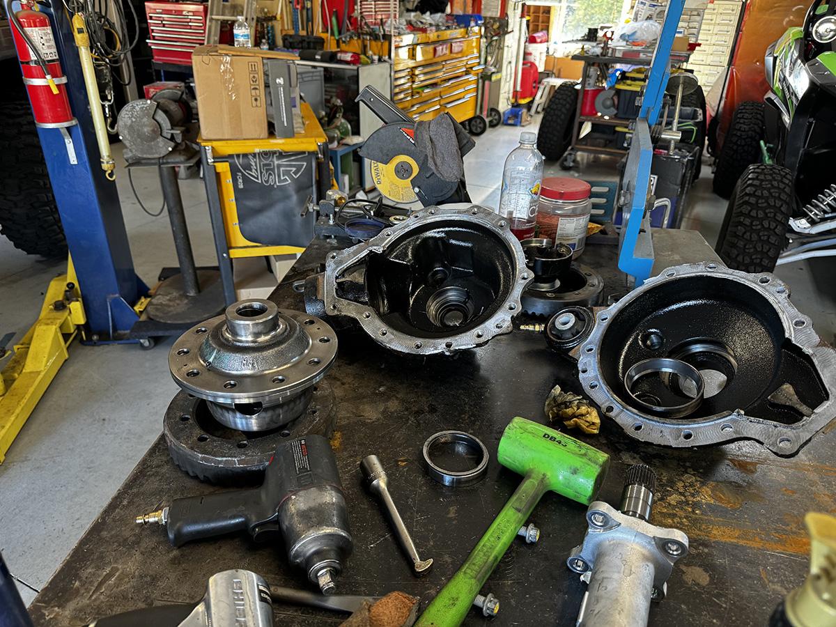

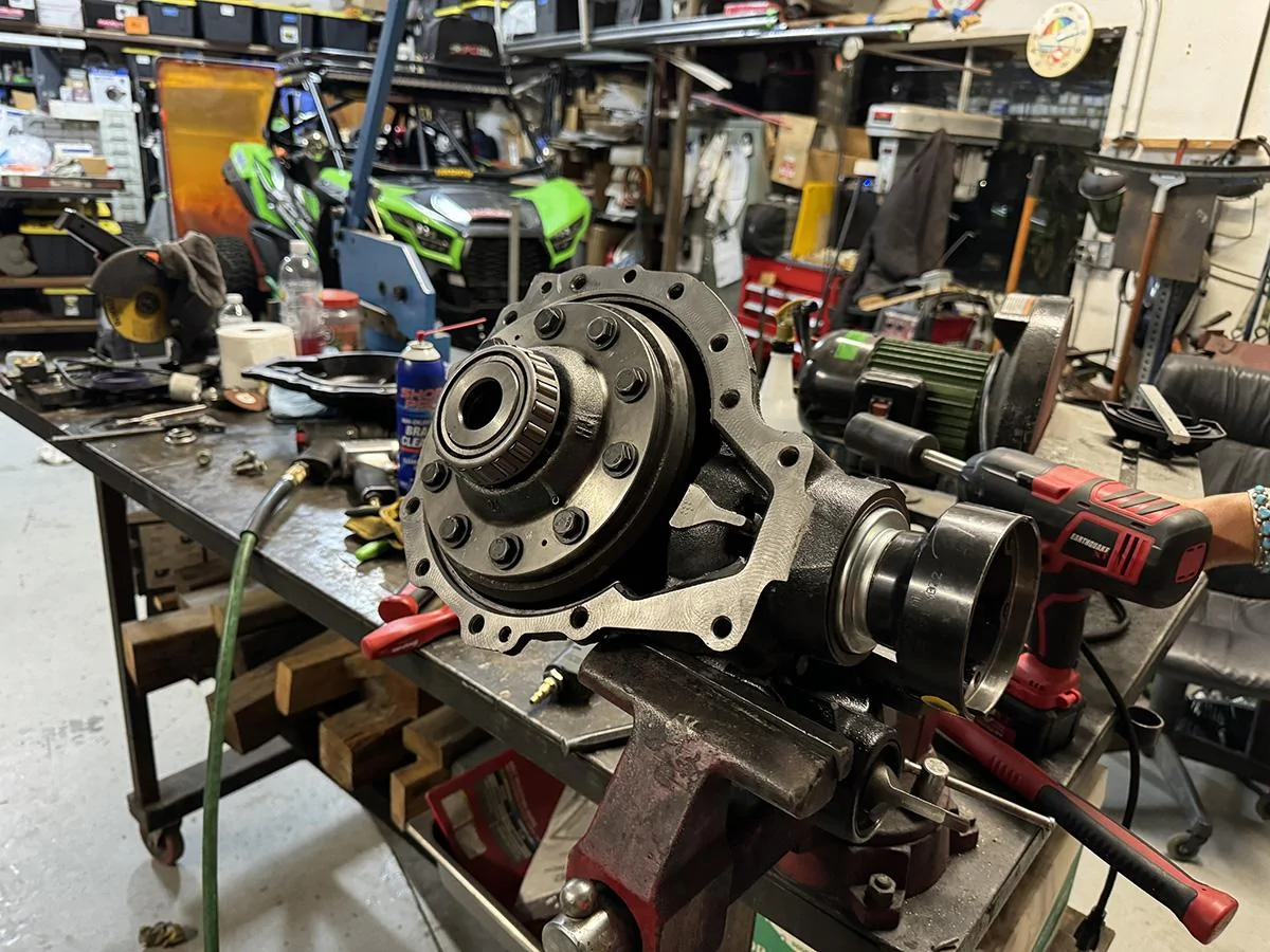

So yesterday I had a chance to load everything up and haul it over to my friend Mike Duncan's shop (4XDoctor) in Riverside to set these up and independently verify, for myself and for the rest of the Internet, that yes indeed you can re-gear the factory Bronco M210 to lower than 4.70. Now, Mike is mostly a Jeep guy doing straight axle gears out of Jeeps and Early Broncos, but he'd done a few IFS front drive units so he was somewhat familiar with them. I'm not going to say the Bronco M210 FDU didn't throw him a few curveballs. But he figured it out and got it all set up. The final result is that the gears fit fine, the setup went fine, all of the bearings, shims, crush sleeve and seals that came in the Yukon install kit were correct for the application (not simply re-purposed from the Jeep JL M210 as some have found with other install kits). Basically, once we figured out how everything comes apart and goes back together, everything went smoothly and fit just right.
So the FDU is now buttoned up and back sitting on the bench in my own shop ready to be installed. It got late on us so I left the rear end with Mike to do at his leisure and I'll pick it up later this week. But there was no question about the M220 so I didn't see the need to hang around for that. I won't actually get these installed into the Bronco for at least a month though, as I'm waiting on some other stuff to come in so I can do everything at once. So I can't give you any seat of the pants or performance results yet but I can only verify that yes the Yukon gears do fit and everything in their install kit fits and works as intended.
